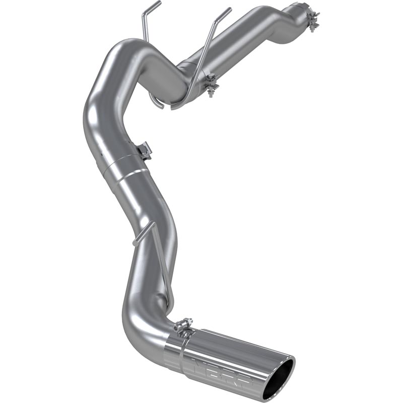

I have my eco diesel deleted but it still has the stock resonators and muffler. I want to straight pipe it but cant find anything online for it because its single outlet out passenger side, do you know anywhere only for a straight pipe cause id do it myself or would it be best for me to take to a local exhaust and muffler place? p.s. im not worried about emissions testing as im in Alberta

On our trucks, it’s 3” from turbo to muffler. 2-1/4” for the outlets if I’m not mistaken. For dual outlet, the hemi muffler delete works in its place. 150ish off Amazon. Had to cut about 6” of my trucks straight pipe but slipped in nicely. On the single outlet, mbpr sells a straight pipe kit. I too have my stock tips and resonators. At 80 with a load, it’s not much louder inside the cab, but get in a tunnel or ask your neighbors and it can get outright loud lol I don’t see why the single pipe muffler delete wouldn’t work on the single outlet setups.
