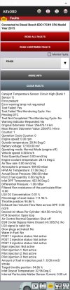

Ok so I have a 2015 Eco diesel with 183,000 on it. I've had a handful of issues with it but all have been covered by warranties or recalls. Just recently we took a trip to Florida, well on our drive back home to Indiana, we got about 200 miles from the house and the message came across the dash for the dpf filter being 90% full, so I kept driving it, about 50 miles later it went to 100%. I kept driving it got it home..next morning I had to go into town, pickup started fine went to get out on the highway and my service electronic throttle sensor came on. And put me into limp mode. I've tried clearing the codes to get it to Regen with no prevail. I've bought new code readers, used Alfa OBD nothing, cleaned out the EGR tube, nothin. Soooo my next step is to delete it which I planned on doing anyway. BUT all the tuning sites say that you need the codes to reset before initiating the tune. How am I going to get this crap reset so I can delete this shit box?
