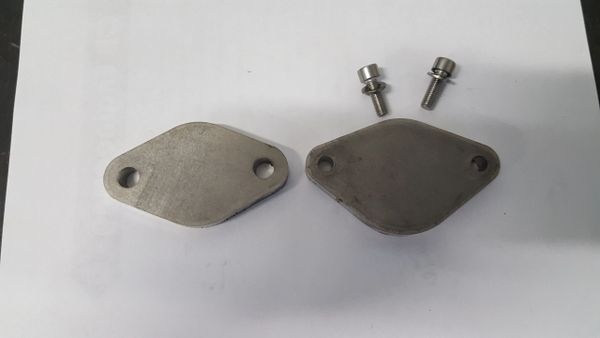

Very simple question: is there a EGR Delete option (kit) that removes only the recirc tube/pipe between the EGR cooler and the intake manifold? I'm asking in the spirit of Keep It Simple and as near-to-stock as possible AND easily reversible. 99% of EGR Delete discussion I see on here deletes recirc tube AND the cooler itself so I might be missing something fundamental about this. I have the GDE tuned ECM on my 2015 Ram with 27k miles. I was going to go ahead and do the cooler recall/update and hopefully address this reliability weak link. I have third party extended warranty but also have the Dieselgate #1 ECM update (installed before GDE ECM) factory extended warranty that I might need to use at some point in the future, which again was motivation for keeping it reversible. I am NOT installing Dieselgate #2 update (obviously). Call me crazy, thanks for your feedback.

Yes, most egr kits come with the Plates to just block off the tube. Mine is currently in that configuration

I spent the extra 50$ on eBay and got all the parts so if I choose to have my egr fall completely off I have the plates on hand
