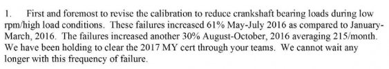

Does a count exist of how many ED's were made and how many were as problematic as Spider's???
I mean if it were as bad as his, we wouldn't have so many with over 150+K miles....no?
I can't lie, I'm paranoid about owning mine now....so I started looking at used F150's with their Ecoboost....then I learned those weren't exactly reliable until after 2017...... So whos TF makes a solid truck with a solid motor??? LOL!
BTW I traded in my 2014 Ecodiesel 1500 because I couldn’t bring myself to sell that piece of s**t to some unsuspecting buyer. I was told by more than one to get rid of it before it has major lower end failure. Also, the extended warranty issued to 2014 owners didn’t cover any other year Ram Ecodiesel trucks if I’m not mistaken. It was a bad design from the start and the problems were still in abundance even through the Gen3 versions. So all of those buyers were stuck with paying for the repairs.
Early on 2014-16 2000-to 2200 Eco's per month production rate, So Most Powerplant makers would stop production at 1 Per 1000, Fiat just continue production at the likely hood of owner's failures at rate 200 times more likely than the most MFG, heck some makers are 1 per 2000 Rotating mass failure.
