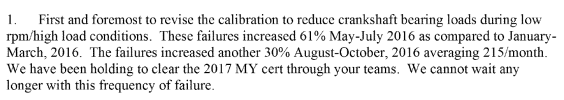

Yes... some have had success with goodwill....You will need to fight in most cases. We have documentation that VM was aware of the Failures dating back to 2016... You can find the info at FOIA
