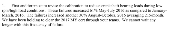

Same here. 2018. 52000 miles best oil no towing ect. Failed. That date will keep getting pushed 30 days then 60 then 90 then no date for a while. Been in shop from 4/23 to 9/23. Finally got it back with new engine under warranty!! Mopar had no replacement new engines, then was told they were sitting in a warehouse for bulk shipping, then told i was 9/36 engines all were bad so final options they stopped using mopar engines for ecodiesel and use US engines out of Ny to build them and took 3 weeks after waiting 5 months to build one and dealership put in and finished in about one week. Problem is only warranty 1 year and not labor coverage. Labor alone was 7800$ and total bill was 35000$. I didn’t get the exact copy submitted to mopar/stelantis but i just got the no charge sheet on what was done but i did read through actual bill. Warranty or not getting stranded miles from home and worry about bad crank is not fun. I may get mopar extended warranty. Wished they could have fitted and gave me the ecodiesel 3 latest one. Not many issues with that. My final warranty ends soon mid October. Bottom end crank failure.

They know why they are failing but just dont seem to care taking the cheaper route. They are not telling dealership this is how we are beefing up crank or making improvements . At a minimum they should be putting in a stronger crank. Tell them that some dealerships are using US engines in Ny as a warrantied engine. You will get it in 3-4 weeks then. Most all crank, rod bearings and so many people on here did not even come close to abusing engines to cause it. They should not even put these back in. I had a 2018 and by then they had enough data to determine a better fix from 2014, but still allowed this engine to be put in and sold it. Just embarrassing r and d and embarrassing for a diesel engine. This is like the 1950s. Never heard of so many of the same engines failing without loading them or stressing especially a diesel. Mine failed driving 25mph!

Agree with the bad engineering and R and D. Just heard from dealership Pump may finally be made early Jan per my local dealership. We all should get ecodiesel 3 with whater modifications were needed to make it fit and run on jeeps gc or rams or buyback for all these failures for sure. Ill at least keep posting this below. Snapped or broken crankshaft. 52000 miles.
