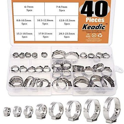

Can you just replace the hose material for the turbo coolent line and re use the other parts ?

Can you just replace the hose material and re use the other parts...
Karl
Yes. Here's what you'll need:
